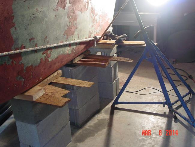

  5. #410
    Feb 2013
    Oklahoma City, OK
    101
Size:  43.9 KB Thank you Bill, Mike, Ebb, When I took the boat off the trailer it was just high enough to place 3 concrete blocks underneath in series which by dumb luck was just high enough to slide the rudder out, whew. Ok Bill you talked me into buying a manual and yes Ebb I'm glad someone didn't have the bright idea to 5200 the shoe on to the heel. The third plank appears to be put together with drift pins and maybe the second as well. I'll know more once its clean. It does look exactly like the rudder in post 100, of this thread. I have been scouring the forum and searching. I'll check out all those post you pointed out soon. Thanks again

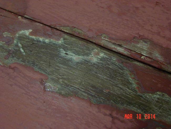

  7. #412
    drift pins
    Drift pins are usually metal.
    If metal (bronze or copper) hopefully the planks will separate as they loose moisture
    and you can use an ocillating blade like a Fein Tool (buy a cheaper one with a Bosch
    dog leg metal cutting blade) to separate the planks.
    Before you start cutting see if you can DISASSEMBLE the fastenings.
    On the edge of the plank if they are wood - look closely for end grain if a dowel. If flat grain it's a plug and there is
    a slothead just inside.
    If you are seeing a fat shadow in the crack, that's a 3/8" machine screw (flathead bolt) or screw. Not likely wood.
    Remove the little 3rd 'plank' first (if there is one), see what's inside. Might find some nuts and washers. Or just screws.
    Bolts you can get out of there - but probably not drift pins. I'd be surprised if drift pins were used.
    IN THE 1"D SHAFT (stock)
    You really need the drawing to locate the fastenings. BUT, of course you can 'see' the heads in the metal shaft.
    There are three screws or bolt heads in each section of the shaft.
    "Upper rudder stock and lower rudder stock" on the drawing.
    Top of the rudder at the beginning of the blade:
    First fastener is a bolt - just before the bend - which presumably goes thru the first board (it is listed as 6" long.)
    Next fastening is a 5" #18 screw - goes thru the bent part of the shaft.
    The lag screw might be difficult to get out. Use a driver that fits tight and to the bottom of the slot of the head.
    [Ancient tip: See if it'll tighten first, a tiny bit - that might help start it, then back it out.]
    Third at the end of the bent shaft is said to be another 6" bolt.
    Lower straight shaft has a 6" bolt near the cut out - at the top of the lower stock.
    Assume that goes thru the first board also.
    Next two fastenings are shown to be 5" screws.
    6 fastenings total. 3 screws, 3 bolts.
    You will note these boards are not glued together. They were bedded with a non-adhesive compound.
    This allows the rudder to breathe when it is in and out of the water.
    It will tend to keep the rudder from cupping and bowing.
    It's natural for the cracks to appear. The rudder will swell closed again in the water.
    Talked with one rudder rebuilder here who glued his together - and reported his blade had not bowed.
    Toast that "solid" Honduras M.
    50 years, hard working, drowned, drillrd, neglected, poisoned, and still a champ. That's amazing !
  8. #413
    Feb 2013
    Oklahoma City, OK
    101
    Screws in the Rudder
    Hey Ebb, yer right once again. Screws in the rudder. Was walking by the rudder and took a look in bright sunlight this morn and there was a mahog plug and another, one fell off in my hand. Slotted screws ahoy. I read most of Tims Rudder/Keel project and that is an excellent article to understand the complex keel setup. Not as simple as I had imagined. The mould idea using the old shoe appeals to me. Thank you guys for pointing out those post. Haven't read the other project yet but will.

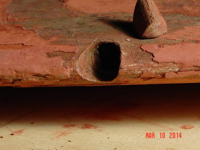

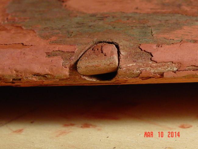

  9. #414
    Feb 2013
    Oklahoma City, OK
    101
Size:  35.9 KBName:  DSC05634.jpg
Size:  37.5 KB The mahogony plug that came off when I brushed it with my hand. The more I look at the rudder the better it looks, the wood is still very dense.

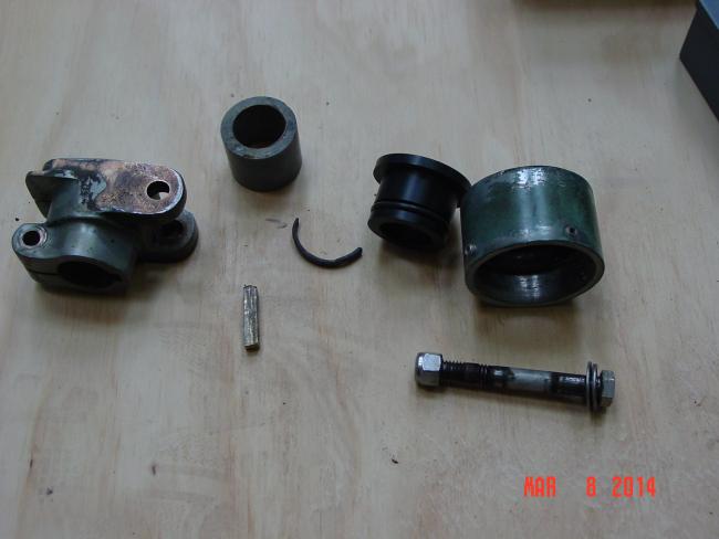

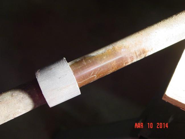

  11. #416
    Feb 2013
    Oklahoma City, OK
    101
Size:  22.5 KBName:  DSC05616.jpg
Size:  28.1 KB The plastic bushing was at the base of the fiberglass tube, it polished the brass. Original hardware, plastic bushing top left, new bushing in center from the Association.

  13. #418
    rudderhead fitting with the fat cheek
    (left side of photo - bottom 416)
    On that head fitting.... that sits on the "stock".... looks like
    it's missing a CAP SCREW. Did you remiove it?
    A few observations:
    That screw is meant to squeeze one of the cheeks it goes thru
    around the shaft....so the tillerhead won't pull off too easy.
    And also help keep the square key from moving around.
    It's not a bolt that goes there! The fat cheek is threaded to receive the screw.
    The thinner cheek has no threads - it's meant to slip the cap screw
    Looks like it's supposed to tighten the thinner cheek a skoch.....
    BUT it's impossible to move it by screwing in the ittybitty cap screw.
    You may break the SB hexhead- fullthreasd 1"-5/16-18
    capscrew if you want to close the gap with it.
    After cleaning crud out of the 'crack', when reassembling, before you
    screw in the bolt, bend the cheek closed (1/32" - 1/16") around the shaft
    with a 'C' clamp,
    (To make it easier, try to 'pre-bend' it before slipping it on the shafthead. Careful....)
    THEN turn the cap screw in with LANOCOTE or Tefgel.... just barely tight.
    Lanocote the key too. I'd smear it on everything - keeps the salt crystals out.
    50 years ago, when it was new, it probably fit pretty good. Now the rudder head
    sits loose on the shaft. Somebody here SHIMMED his with a piece of pepsicola can.
    (onlinemetals has pure soft copper shim sheets. Like a footsquare for $8)
    At least one other owner has drilled and tapped his rudder head for one or two
    316 SET SCREWS (10-24 - McMCarr) that penetrate into the rudderhead KEYWAY
    - to press the key against the shaft.
    The problem with that is remembering them when it comes time to take it apart.
    A great idea is also to countersink the KEY to receive CONEPOINT set screws
    to keep the key from slipping out of the head keyway. Imagine the strain on
    the top of the shaft there .....as you push & pull the tiller a million times.
    One more thing that removes slop from the steering system.
    Photo at 415... Oddest looking plug I evah did see!
    Whuts in there?
