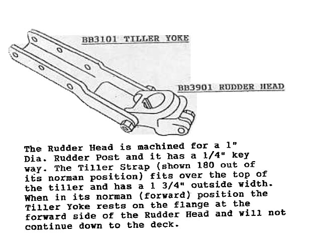

    Because Commander #92's tiller yoke is broken, I am considering Bristol Bronze part BB3101. Can someone confirm this will fit onto the existing rudder head. I would prefer to not replace that part as it appears to be in good condition.
    Bristol rudderhead
    Yes, that kinda looks like a replica of our 4.5lb monster.
    MAY BE OF INTEREST:
    My tiller-yoke varies at the narrow end from +1 3/4 to -1 3/4".
    Inside (where the wood goes) it's 1 3/8" wide and 1 1/4" deep.
    The fat end, where the head hinges on a 3/8" bronze bolt, it's
    2 1/4" outside, and 1 3/4" wide inside where the rudder head
    tightly fits. Yoke 8 1/2" long.
    Head is too complicated to express with measurements, but
    it could be done. The head is arse backwards in the drawing.
    This drawing is WRONG according to the rudderhead in
    my possession. Imagine swinging the rudderhead in the
    diagram closed in its housed position... The socket that
    fits over the rudder shaft end will here be positioned
    coming out of the top of the fitting! The tiller stop "to
    keep it from continuing down to the deck" is accessed
    only when tillerhead is fully housed in a 'closed' position.
    That flange
    (in the drawing under the two letters in BB 3901)
    should be bearing on the inside of the flat top. Rounded
    top of the head casting is what we should see in this
    open position upside down drawing - but rudder head is
    flipped. That flange will be seated against the under
    side of the flat top between the hinge arms of the yoke.
    However, the rudder head in the picture is so wonkus
    inaccurate that we can't even be sure what's depicted
    is merely a confused doodle of our original fitting.
    Looking at the drawing,
    if we mentally move the rudderhead fitting (BB3901) around and
    inside the yoke, that flange under the BB in the drawing is what
    a functioning tiller yoke (with its tiller) rests on when the tiller is
    down. The drawing figure cannot be repositioned correctly,
    because the artist was very confused. So you better call Roger up.
    Bristol Bronze. 1-401-625-5224, ask if anything's changed.
    Simple thing to say is: If the head shown in the drawing is swung
    180 into the yoke (which supposedly would be letting the tiller
    down into its streering position...) the drawing shows that the
    socket connecting rudder-head-to-rudder-shaft would point up to
    the sky from the top of the Yoke.
    No joke.
    Point being, the rudder head sits stationary (except for moving
    - but hopefully firmly attacted - with the rudder.) But it's the tiller
    yoke that does all the moving (up, down and all side ways).
    When you buy it, if you find the tiller yoke and head to be a true
    casting of the original, you may find the head fits a bit loose
    pearched on the top of bronze shaft.
    Someone once posted here that he used (4mil) aluminum from a
    Pepsi can as a shim to tighten up the free-fit.
    McMaster-Carr has $$bronze shim material. 316 is OK. $10.
    The 1" 5/16" hexhead MS that is threaded into the thicker side
    of the split socket head, looks like it is there to squeeze the two
    halves tight together, doesn't really do that too well. Therefor
    need for shim material. Approx shim size: .75"x2.75"
