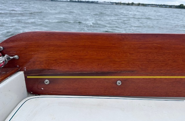

    I have a horizontal crack in my port coaming. Looking for ideas to address. Hasn’t fully separated, but cracked enough to wiggle. Afraid it won't survive the season unaddressed.
    A dowel jig and long bit would allow drilling several top to bottom 1/4” holes and epoxying a mahogany dowel in the hole, but I’m thinking that a dowel won’t do much for reinforcing the inflection point of the crack.
    Maybe there are 1/4” bolts that are long enough. McMaster-Carr has threaded 1/4” 316 SS rods, but not sure about how to terminate on the top of the coaming. Maybe machine a flat-head screwdriver slot in the top of the rod?
    Also thought about a 1” SS 1/8” flat bar - kind of like perpendicular Band-Aids. Maybe also some angle bracing on the outboard side.
    I’m thinking the fix may be unconventional, so open to suggestions.
    Photo is of the crack - the yellow line is the outboard deck level opposite the photo.

    I think pull it off, slightly pry apart at crack and insert glue or slightly thinned epoxy into the split, let that dry/cure (clamping to hold proper position?). That'd probably hold well enough if you got a good coverage inside the split, but you might as well go all out... -> Once dried/cured, go for dowel insertion from the bottom. It's closer from there (so less drilling/dowel length needed), and will be 'hidden' when done, and that means a bonus - water will find it harder to get into.
    Looks like some water got in already, so you might want to allot some drying time pre-repair. May be that removing some of the finish around the 'wound' will speed drying.
