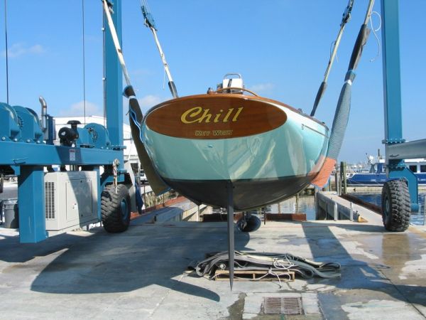

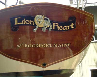

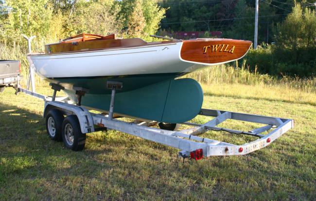

    Quote Originally Posted by carbonsoup View Post
    how do I go about paint matching this?
    The PO - "tha3rdman" - mentioned Awlgrip Matterhorn White for the decks earlier in the thread. I'd think he probably used the same paint manufacturer on the hull.
    Personally, I've always thought a wooden overlay on our Alberg transoms would look really nice:
    It worked for Jimmy Buffet.
    More to scale.
    Or, if you want to get really fancy.
    (I thought I had a pic of a CD22 but can't find it.)
  9. #189
    Sep 2012
    Philly, PA
    179
    ooo. nice, hadnt thought of that, but im not sure a wood stern would go that well with fire engine red. maybe some day if i repaint the topsides.
    as far as the color is concerned I guess I could call the little boatyard in Havre de Grace, they may have someone that might know.
  10. #190
    Sep 2012
    Philly, PA
    179
    well, there is 2 inches of standing water on the lawn (swamp) due to the latest, and hopefully last, winter storm here in MD, so I thought I might post some questions... i have completed the cabinetry of the galley, port settee and the stbd settee base. I stopped after glassing in the stbd settee base as I am not sure as to how the attack raised portion with the sink, shelving, storage and swing out table. I am going to pick up some materials this afternoon so i might have a better idea tomorrow.
    Anyway, i moved forward into the v-berth area and had some questions, particularly about a marine head. I was not sure about wether or not I was even going to attempt plumbing a toilet... but alas as I started to kick around layout ideas I felt that I could make it happen. So, the question I have is: is the possible location for a holding tank (seen below) make sense? and what is a an acceptable minimum size? and should I make a box or can I just glass a holding tank in place, directly attached to the hull?
    What you will see below is a piece of template ply with a 12"dia round on the side closest to the door frame extending to the port side hull. If you were to extend the lines of this shape straight down you would see what I am thinking for a holding tank. I would guesstimate being around 5 gal. The top surface of the holding tank would be the footwell for the main salon double birth. The toilet will be just forward of the holding tank, mounted on a pedestal, positioned as close to the port hull surface as acceptable.
  11. #191
    Sep 2012
    Philly, PA
    179
  12. #192
    Sep 2012
    Philly, PA
    179
  13. #193
    Sep 2012
    Philly, PA
    179
    You will also notice the single birth mocked up on the stbd side. Its pretty high up and I was thinking of having the top hinged at the hull intersection to allow top access. Being as deep as it is it should allow for storage of some pretty bulky items... a sail locker?
  14. #194
    Sep 2012
    Philly, PA
    179
  15. #195
    Sep 2012
    Philly, PA
    179
    Not exactly sure what is going to happen on the port side of the v-birth area, however I do know that the 31 gal Vetus flexible water tank is going to go where the rusted out OEM water tank was located. The increased size of the tank is going to make the cabinet containing it extend from the forepeak bulkhead to the pedestal base of the original marine toilet location. We will see how the tank and the seacocks like this arrangement...
