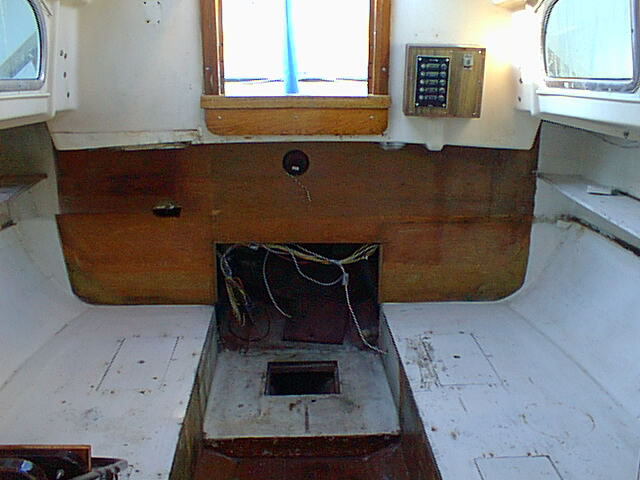

While some of you were relaxing this weekend or perhaps even sailing...congratulations Mike I'm just begining to comprehend... I FINALLY got to work on 113 for close to five hours. Now that may not seem like much to many of you out there who enjoy 'simply messing about in boats',but it's the longest stretch I've got to work on her since bringing her home in May 2001. I've wanted to rearrange some things all along and the whole 'bulkhead thing' has proven to be the catalyst to get things started. We're not going as far as shag carpet, but I pictured something a little bit taller, maybe U-shaped, maybe curved...

Tony, as you may have read here I'm doing a bunch of unauthorized alterations. There'll be a new bulkhead right where the original head used to be where I can imagine a Lavac with a small holding tank on the forward side of the bulkhead in the forepeak. That's an other time. There'll be a sanipotti in the V just where it used to be and a curtain at the compression beam.

An unsupported (in the middle) xompression beam can be a little un settling to look at, I guess. Someone has said that a single compression post was great to grab and swing yourself around with, in or out of the V-berth area. So you could keep it wide with that fine laminated beam you have, supported at the ends, and use a curtain for privacy, rather than that tiny opening the originals have.
I've just removed the 1/4" teak ply in small jagged pieces from the sole. It was tough as nails and stuck down with a mean rubber mastic. In some places we pulled the glass cloth coating off the the 3/4" stuff underneath. But instead of the mystery space between the teak sole and the hull sides, now we can see that the sole is glassed in in the usual way to the hull, and it'll be a piece of cake to cut the plywood out. IMCO it would be easy to lower it.
Intend to take it out, clean out the last of the original remaining paint from the bilge, glass in lateral supports in the form of frp bulkheads or floors, and reclose it at about the same height thereby creating an extra tank. For rum. Or gin. A very stiff bilge tank. Whats keeping me in check at the moment are decent waterproof cleanout hatches at a realistic price. Each bay needs access
