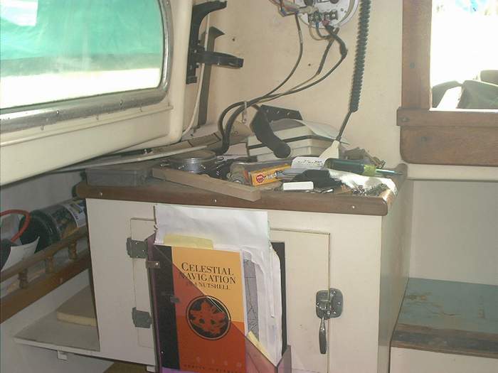

Here is what my old friend looked like before I started.
I know, shameful. It was always good for collecting all the junk that piled up as I was working on everything else. The purple magazine rack..... that I will not miss. :D

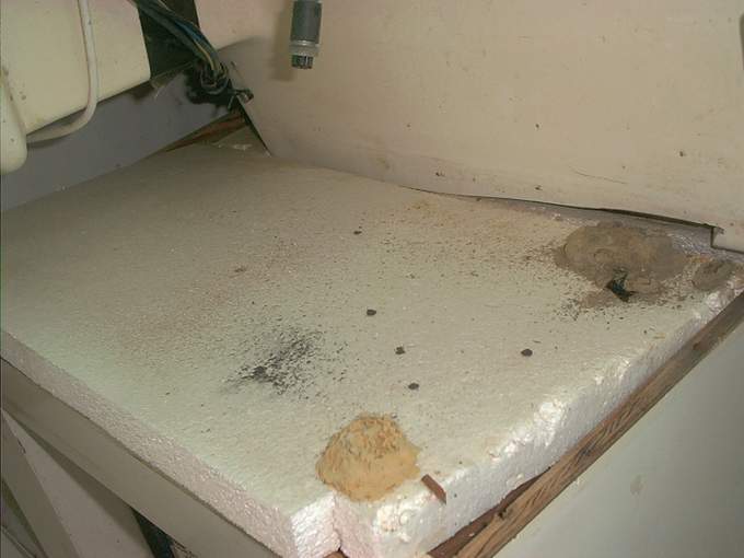

The insulation around the frame

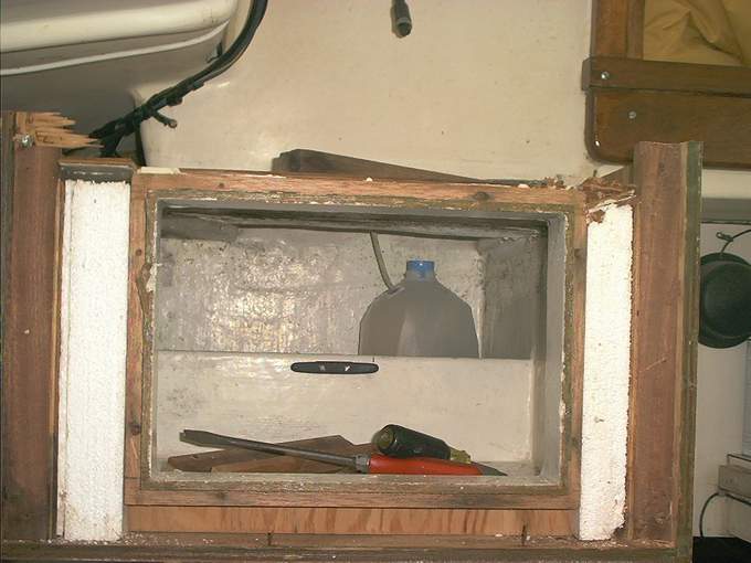

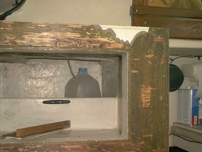

Here is the insulation behind the front. Now, if this were it I would not think too much of it. The design goes on.....
An idea of where I am going...

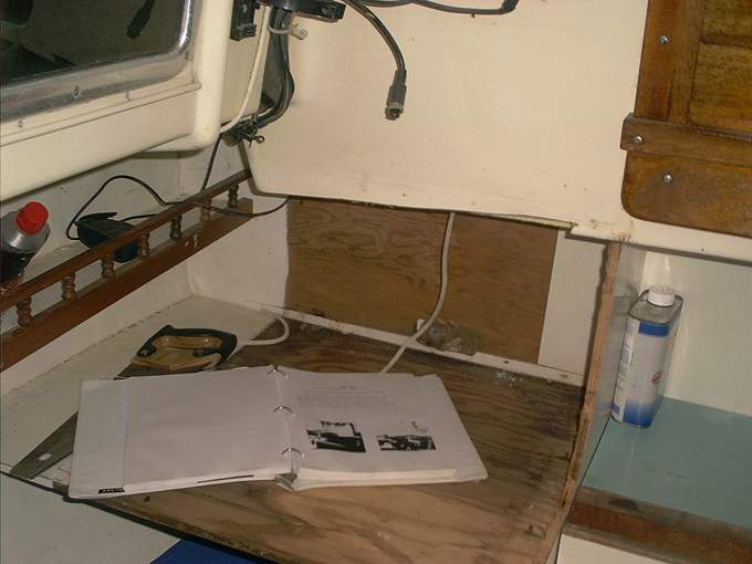

Here it is with the original base in place. I will not be using it, except as a pattern but it gives a good idea of the size of table.
Just right for the manual! :D
I am leaving the side of the old ice box (inboard) to partition the space. It should keep the pots and pans from sliding ALL the way across the counter..... At least I hope. :D

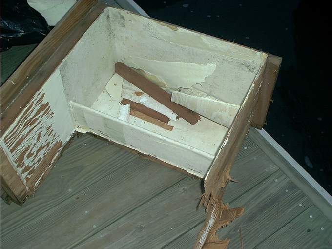

As for the purple magazine rack, sadly it was destroyed in the effort. :p
Gnawed it out like a dog.
I basically gnawed it out like a dog.
I was prying, and pulling. The plywood tore as I pried it where I could not reach the screw heads (mainly the ones run from the inside that had been glassed over). I avoided the hammer, as much to keep from poking my eye out as anything :eek:
