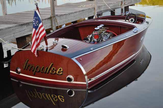

With an eye for old Chris Craft style mahogany boats, I always wondered how they get that rich red color out of mahogany. Tempted to use these techniques:
(http://www.vintageraceboatshop.com/Stain-Varnish.htm)
...on my campanionway and hatch boards. I searched and found mentions of filler stain on the first page of this thread - wish I had run across it before finishing my coamings.
YEOWZA!
Attachment 9429
And a great site, great fotos of a traditional varnish job... by seven curmudgeons:D
....with a fine modern varnish. That ChrisCraft is a jewel-box, and keeping up with
it is going to take a lot of varnish love and a lot of Clear Gloss Epifanes.*
From the photos, it's difficult to see the difference between the three choices of
filler stain. Color intensity seems to change. Would choose the brightest red under
multiple coats of UV varnish. Have to buy into the Interlux/Petit system... Have
to admit the result is fantastic. Can't imagine keeping up with it on a boat that
lives outdoors!!!
