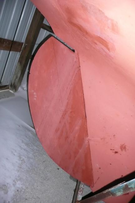

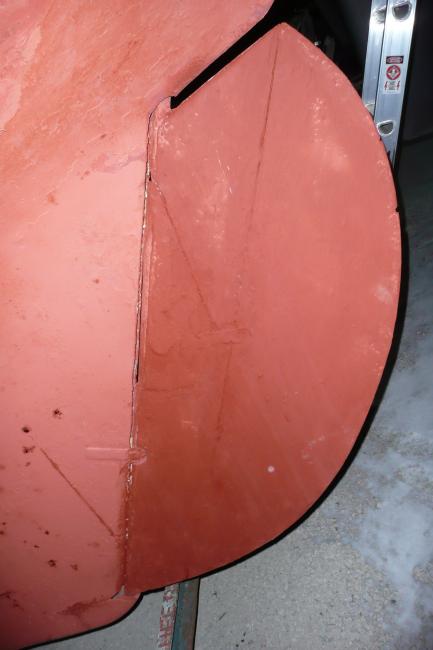

A plug in the rudder is a good idea, I may change my mind about an inboard. My goal is to voyage by 2016 so I have a little time. If I can duplicate the original within reason I would be happy with that but a more high tech would be even better. This pic is an older one before I brought it south. A lot of that paint came off over last summer and I peeled some more off with a putty knife. I gave the rudder a workout last summer and didn't notice failure of any kind, but I will take it off as you suggest.Attachment 9165 Attachment 9164

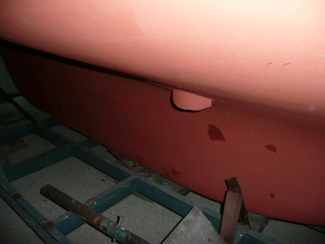

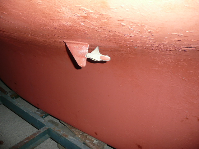

Attachment 9169Attachment 9168 Major Drag
My conclusion was this: It is very hard to improve on the boat as far as speed is concerned. Every little bit helps for sure but hull speed is reached and then some and then after that you just can't push em any faster. One reason we did well is the boats exceptional handling when its blowing like stink. Several of the races I mentioned were in 25mph and up. Its very windy here. Some of our competitors dropped out because of strong winds Bill please forgive me for posting the mast base photo twice, I am a klutz on the computer.
One more thing, the reason I posted the knotmeter instrument is to say that I have removed it. I could not find a replacement prop. I am considering making a taffrail type unit using the knotmeter head and making a box to contain it, dragging a prop behind the boat, because the head still works beautifully. I have installed a modern knotmeter in the bulkhead but it uses power and probably won't last 50 years like this old one, lol
