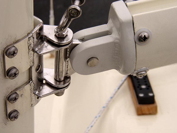

That is definitely a Ballenger mast hinge there, and you wonder about spreading the load. Your interior shot certainly shows a healthy compression set up, as the doorway looks very square.

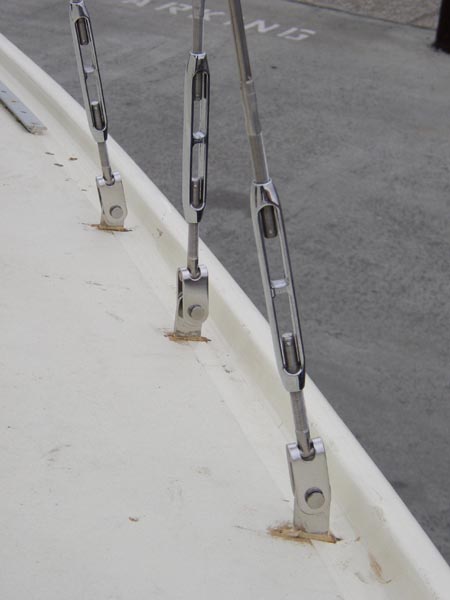

Interesting also are the shroud plates. Can't make them out. Are they rod? How would they be attached inside?

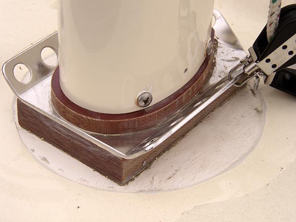

The strongback is stock and probably does not sag because there is only minimum pressure from the mast. I'll photo the forward side, if I get a chance.
The shrouds & turnbuckles are new and stock. The chainplates appear to be original.

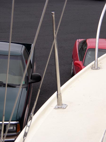

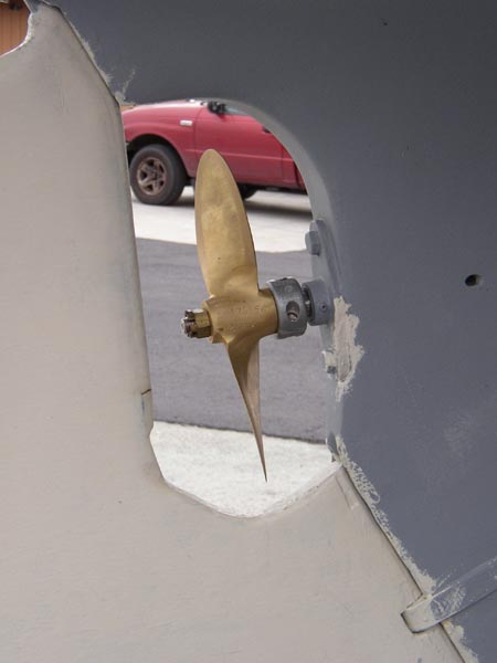

We'll start by noting that the prop is installed:

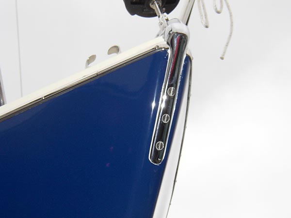

Here's a look at the re chromed stem head on the bow:

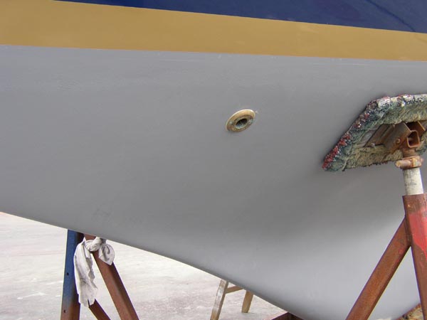

Appears he's using the original through hulls for the head:

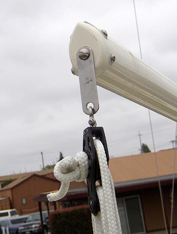

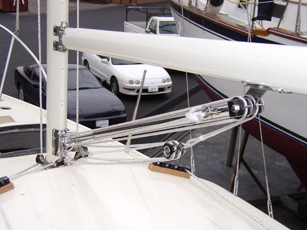

The boom is installed. Here is the mast end?
Here's the aft end of the boom:

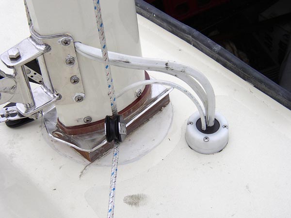

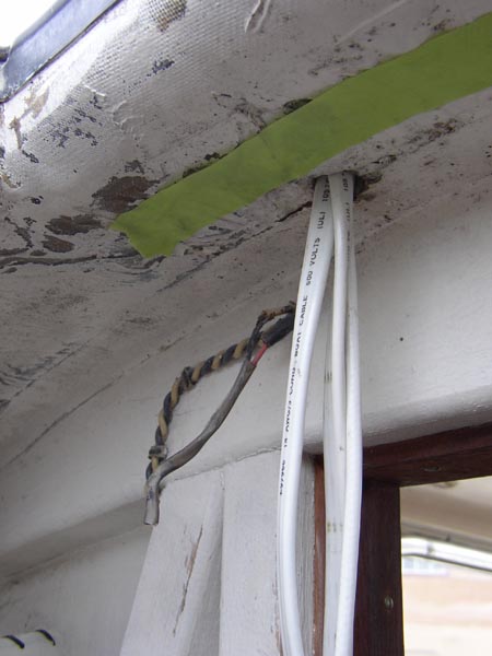

Here are the electrical wires going from the mast into the cabin:
And, here are the wires entering the cabin. Yet to be routed anywhere:
Of course, he installed a Garhaur vang :D

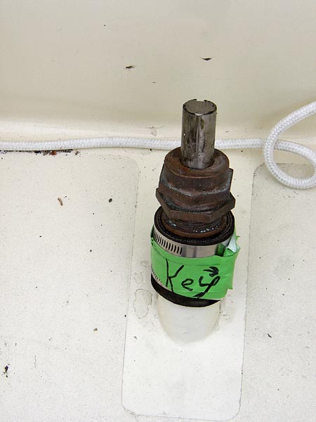

Mast base again. They used phenolic plastic (the brown stuff), not wood.
Saved the best for last :) Seems our hero did not read the latest newsletter and so did not know there was a less expensive fix than going with a Norscot shaft seal!
