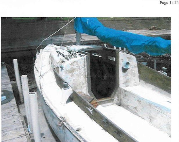

I removed the steps and saw the water was streaming in from somewhere well aft (not the cockpit drains, rudder shaft, or anything I could see with the flash light).
The lazarette was filled with water, which was coming in around the outboard. Ariel Spirit had come with an outboard plug, but there was no way I could lift the 9.9 electric start motor out of the well with the boat pitching about in the storm.
I had already taken down the reefed main, and now rolled the jib in till it was barely flying at all (just enough to keep steerage). The lazarette emptied of most of it's water and the leak subsided.
Later that evening, I was able to inspect the bulkhead in the lazarette and found it appeared to be in great shape. It had been reinforced with epoxy, and looked to have been repaired in a manner consistent with the rest of Keith's work (very well done).
Ariel Sprit’s lazarette only has a floor on one side, not all the way across like Faith. The holes for wires and the like were all pretty high up on the bulkhead so I doubt the water was coming in there.
I have only been able to duplicate the leak by running the outboard too fast (the 9.9 really has too much thrust for and Ariel IMHO.) I can make water come in by trying to push her past hull speed with the motor. I will have Brittany do the 'hose test' to see if we can track down the source of the leak.

The two places to look:
1. There is a one by something beam that forms the bottom of the motor well running perpendicular to the hull line. The plywood bulkead is attached to the forward edge of the beam. The assembly has a layer of fiberlass over it in the motorwell. However, if the water gets between the panels and the beam at the bottom, it can bypass the fiberblass barrier. As I recall, I think I drilled some holes and filled the gap between the two (going down to the hull) with resin. That seam not seems to be secure (how about that for a pun?)
The second was at the top of the bulkhead panel in the corner ( in my case on the port side). I found it not with a flashlight, but with a hose pressed up against where the deck and the bulkhead meet. That was really obtuse and hard to fix, requiring some routing out of the glass to get to the pin hole. I now almost have it, but this past weekend noticed a bit of water trickling in. The answer will largely lie in whether the water comes in with just the motor running (the boat is relatively level but the engine well flooded - in which case the leak is from below - or when the boat is healed, regardless of whether the boat is under power (in which case the problem is at the deck seam.

The wire holes through the lazarette bulkhead on "Augustine" were very high up on th ebulkhead also, but that did not prohibit the filling of my bilge in an alarmingly short time. The opening had been taped, but all of that water was squeezing through nonetheless. I removed the ancient Loran antenna wire on the starboard side, and repaired the bulkhead with epoxy. I used a water tight through-bulkhead fitting on the port side navigation light wires. That stopped the leak.
Thank you both for the replies.
I got it. I understand that the lazarette bulkhead must be pretty much water tight all the way up to, and including the joint to the deck.Quote:
I will talk to Ariel Spirit's new Captain, and revisit the lazarrette aboard 'Faith' also.
Thanks for your help. :D
the water may also have come from the rudder post shaft.especially when porpoising up and down in any kind of sea way.I had that happen on many boats----especially while motoring.it has also come to mind that it may be a bad idea to store any outboard horizonally on its side---probably best to keep uprite at all times----as the rolling action of any boat may tend to allow any remaining seawater from a lower unit to find its way somewhere into the power head----rendering it useless when needed most.also all the inspection you can do at the hull/deck seem may result in not finding any leaks.however these boats are in fact flexible---after being under way for any length of time---be it a day or 40 days---these hulls will flex over time---resulting in a hull/deck deficit not seen before.

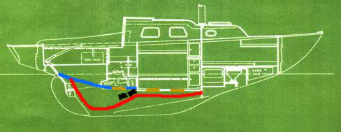

So the question arises: How and where to mount the electric pump in my Commander? Do I just place as far down as I can through the first undercockpit access hatch. It appears as though that it where the pickup for the Whale is located. Or do I insert as far as I can aft through the aft hatch in the cabin? Then I can find an easier way to run the electrical.

I have two Shurflo* submersible bilge pumps that are going to get mounted to a leftover piece of 3/8" polycarbonate that will be positioned nearly vertical in A338's tiny narrow sump - which is right at the end of the glassed over encapsulated ballast under the bridgedeck.
I will, like others have done, put the tiny 3.75Amp 1000 pump at the bottom of the board and the humongous 8Amp 1500 pump about 9 inches above it.
As you know, the theory is that the little one will do 99% of the work and take care of piddlly stuff - and is cheaper to replace. The big one supposedly will move a lot more, more rapidly, and probably no where near enough in a real crisis.
There is room in the sump, barely.
The Shurflo pumps are modeled differently as to where the outlet hose is oriented.
But I think there is a way to get both hoses pointed aft while attached to the pull-board.
And there are no intuitive attachment points on the pumps for mounting.
It's possible that hose clamps could be used to strap the pumps to the board.
Each strainer can be attached to something flat underneath, but disengaging the two spring latches that hold the strainer on to the pump body is a problem - even on the midget.
Therefore designing someway that both pumps can be pulled up out of the sump is necessary.
While this sounds right, doing it with attached hoses and wires is a problem.
There can't be any swags in the hose as that limits 'head', so there isn't a possibility of extra hose length that would allow the pump array to be brought into a convenient position - like for unscrewing hose clamps, or clearing the strainers. And also for plain open access to the sump for cleaning.

SkipperJer,
I have a Commander and can easily find the Bidge access 1, 2, and 3. I don't see an access hatch for #4. I have the model without the inboard...have an outboard in the well.
The batteries for my electrical system seem to be where access 4 is. I moved the batteries and don't see an access hatch. Do some Commanders not have that access point?
thanks, mike
Mike,
I not sure what you are looking for. I have three openings in the cabin sole: one forward of the compression post and two aft of the post. That's all I know of. You can see all the way to the bottom of the bilge from the third opening.
I've seen several locations for batteries in various Commanders. The terminal strip is usually (not always) on the starboard side mounted on the interior of cockpit wall. I originally found my battery in the starboard cockpit locker just aft of the terminal strip. I've seen them under the cockpit floor behind the wall between the cabin and the stern. To me both those locations made the batteries hard to move and service. I relocated mine to a battery box in the cabin under the bridge deck just aft of the ladder. I have it strapped to the wall. It puts it low and centered in the boat and is easy to get too when needed.
Does this help?
Thanks SkipperJer,
In my question I was trying to ask about the existence of "Bilge access 4" in the attached diagram that I thought you posted. What you described in your note is the same kind of Bilge access I have: One hatch in front of the compression post and two aft of the post. But in the diagram there is a 4th access which I can't find on my boat and it sounds like you don't have either. So why is it in the diagram?
My farthest aft bilge access is only about 10 inches deep. It sounds like with yours you can see deeper into the keel. I wonder if someone just sealed mine. I often get water in it...I think it is leaking form above...so I'm reading about bilge pumps and searching for leaks.
I appreciate you comments on the battery. Mine are under the cockpit floor and I like your placement better.
thanks, mike
Attachment 10317
Depending on the era when an A-C yacht was manufactured, the factory produced bilges of varying depths. The only constant (almost) was the location of the lead ballast.
In your drawing I don't see anything like bilge access under the cockpit, just the engine location for the on-board power model. If you regularly have water in the bilge I'd recommend you find the leak now. I very occasionally get water when it is raining and the wind is blowing directly into the air scoop in the bow. Otherwise I'm dry with the exception of condensation within the interior when temp/humidity changes a lot. Slow leaks are insidious and often do long term damage to structural areas that are very hard to repair.
